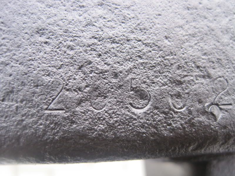

              • Jeff B.
                Infrequent User
                • April 30, 2006
                • 28
                Re: 72 Vin #'s
                I was able to get a decent photograph of my June build 1972 with the body on and without the tank.
