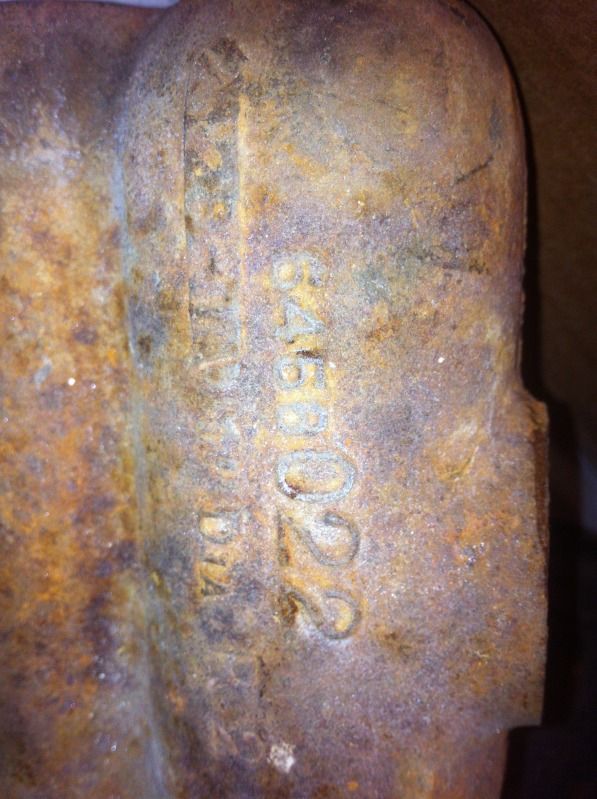

            Re: 56 Brake Master Number
            Casting number 5456022 cast on side in equal size numbers just above the 1" bore size identification.
            Metal plug on end stamped with 5454480

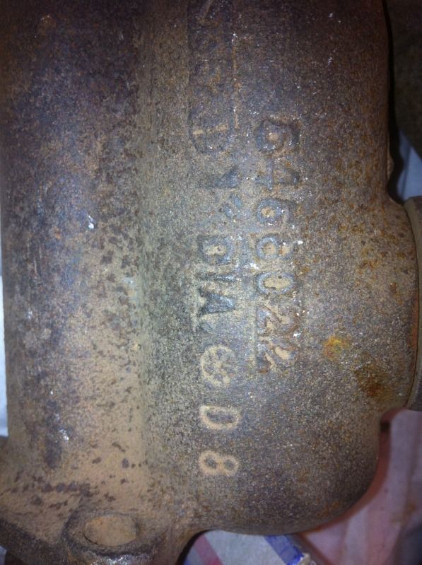

              I have some old brake parts; thought I'd post photos to this thread.
              Looking for identification.
              G
