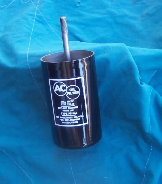

    All engines through '67 used the PF 141 oil filter canister. Spin on filters did not arrive till '68. If your engine is using a spin filter it is incorporating an adaptor or you have a '68 and later V8.
