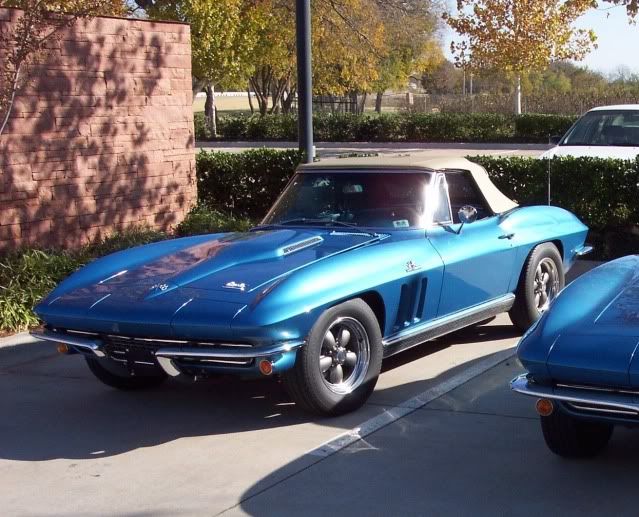

            Here's my '66 sporting a set of Uniroyal 205 75 15's. Overall height is close (enough) to original size of 775 15 as to not cause significant descrepency in speed read out. Besides that..........blackwalls look menacing!.....lol.
