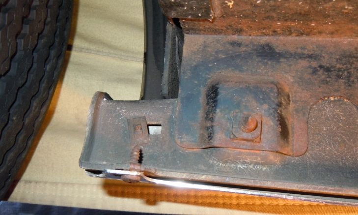

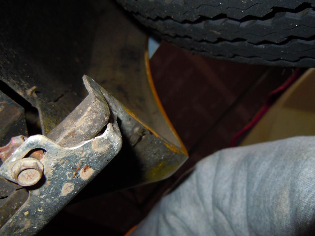

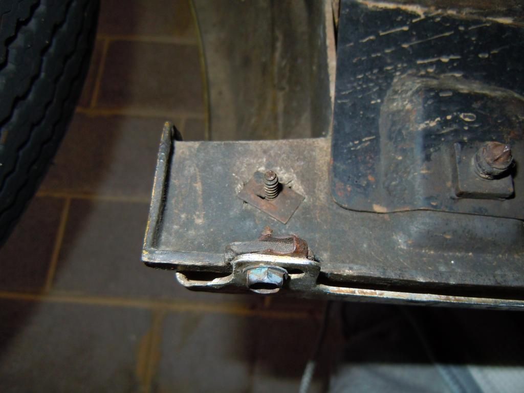

            1971 # 8555
            1972 #20942

              1971 # 8555
              1972 #20942
              The blue on the 1972 hex-head attracts my attention. IIRC in the early 1970s that blue was an indicator of a metric fastener. It was intended as a head-up to the mechanics to reach for their newly acquired metric tools.
              BTW: Very nice pictures Kevin.

                Terry, I believe that around 78/79 we started seeing the blue colored bolts and nuts from GM.

                  So if I am off by half a decade (and maybe I am), why is this one blue? Not defending my date estimate, only asking about the finish that looks out of place to me.
                  Maybe it is a lubricant or something else??
                    Terry, must kicked something up while driving??
                      Drivers side,

                        This fastener drove me crazy! It was one of the reasons I spent untold hours putting together a spread sheet that numerically ordered every piece of hardware for my '73 coupe. I went through EVERY page of my A.I.M., entering EVERY part #, then had computer arrange the #'s. ANYWAY, that screw # was used in two other places on my 73. 1) On the Valves In Receiver bracket. 2) The automatic transmission cable mounting and seal retainer. Sure enough, same finish and size. Awesome! Understandably the cross reference probably isn't foolproof, but at least this time it worked!

                          We need much more data but with this limited sample it looks like the changeover from cross recess to hex was somewhere in the mid 1971 model year. Now we need to zero in.
                          Am I correct in thinking that no 70-72 cars used a nylon insert.????

                            I checked my '71 #4001 with a build date of 12/15/70 and it has the same screw as '71 #8555.

                              My '71 build date 2/2/71 #8417 is the same as Kevins '71 #8555.
