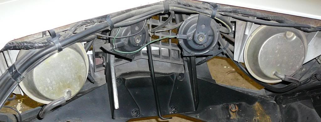

I am mounting the new GM reproduction horns on my 70, but I am unsure of how the passenger side mounts. The drivers side is quite obvious with the mounting tang locating hole, but on the passenger side I am unsure. The car had only one horn mounted when I purchased it. Would anyone have a good picture of exactly how the passenger side horn mounts?

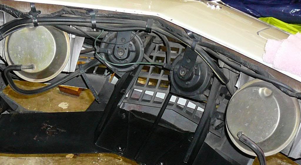

Thank you for the pictures Mike. They mount as I presumed, however, beside the threaded hold on the passenger side, there is no pilot hole for the bent tang on the horn bracket, but the drivers side has the hole for the tang. Could the nose support bar have been replaced with a newer style one at one time? I have read the 71 and 72 year models only had one horn, maybe the pilot hole was not there on the passenger side on a service replacement part?- Top
Re: 1970 Horn Mounting?
Siegfried, the bolded sentence would be my guess. It was 1972 that got the single horn. 1971 had dual horns. At some time later in the C3 era the second horn became an extra cost option.Thank you for the pictures Mike. They mount as I presumed, however, beside the threaded hold on the passenger side, there is no pilot hole for the bent tang on the horn bracket, but the drivers side has the hole for the tang. Could the nose support bar have been replaced with a newer style one at one time? I have read the 71 and 72 year models only had one horn, maybe the pilot hole was not there on the passenger side on a service replacement part?Terry- Top
