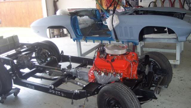

      These are from my 65 coupe built April 65. Definitely has a dash and the date is written by hand. I found the info. that Quanta supplied with their kit was wrong in more cases than it was right.

        I agree. The hand written date continued into part of the 66 model year.

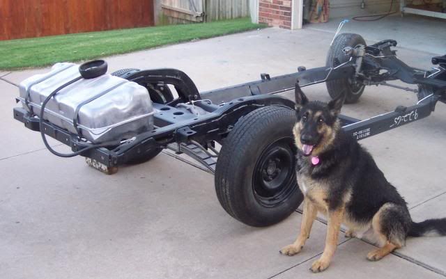

                I'm not saying Quanta's templete is incorrect however havn't seen this information taking 3 lines. Does not apprear typical production....dot included. The considered "norm" is two lines with stenciled date.....or a hand written date at this particular timeline. My early '66 was manufactured in late Sept. '65 and incorporated a hand written frame date. Pardon my dog 'Hammer', he's a picture Hog.

                  Not that I'm an expert by any means but all that I've read and seen tells me the stencil is not quite right for a 65.
                  And as far as Hammer goes, we all need our furry little helpers
                  I have a few also
                  Lief
