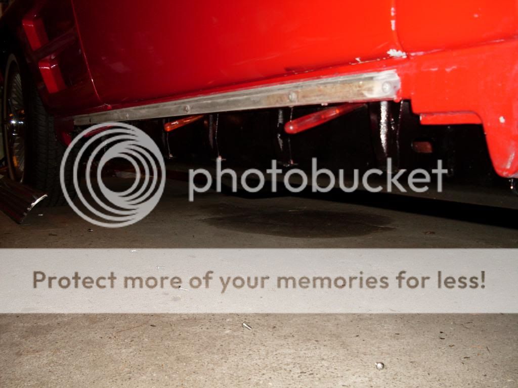

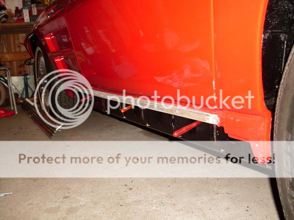

    I am thinking of changing the front to rear brake line that is on top of the frame on the 1963-65 CorvetteAlmost everybody tells me that if i want to put the brake line in the original position on top on the frame i have to lift the body to gain access
    There is no way to get access to the brake line from under the car

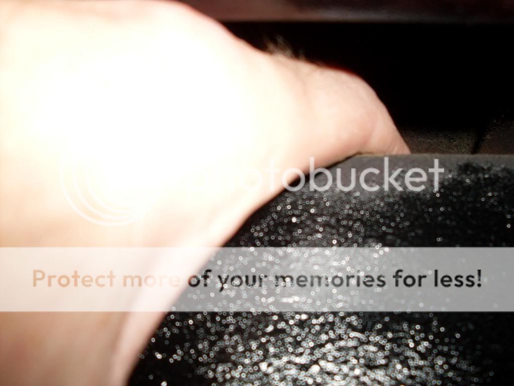

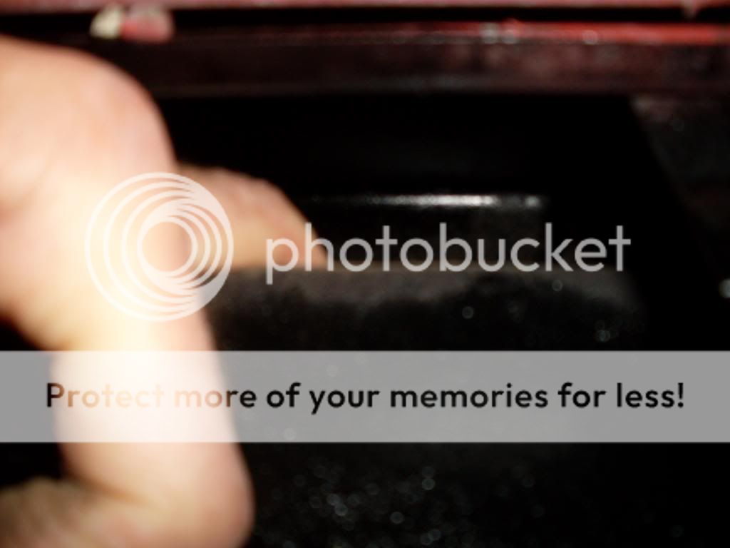

    This evening i took off the left side rocker panel and i can easy put my fingers on both the brake line(all the way)and the 3 clips that holds the brake line
    Note that the opening on the clips faces outwards towards the rocker panel and that makes it more easy
    I wonder if there is any here that have changed the front to rear brake line from the rocker panel side?
    Here is a couple of pictures of the gap between the body and frame
    Each of the 3 screwdrivers points towards the 3 clips that holds the brake line in place
    The 3 screwdrivers is pointing towards the clips that holds the brake line on top of the frame. I can easy loosen the brake line out of the clips

    The major problem I had was getting the new line threaded up & around the back area. The long front straight section needed more to swing up more. I understand (& perhaps you do too) that the body only needs to be lifted a little on the drivers side.
    Before you remove the present line try to thread the rear section from the rocker side, sounds possible.
