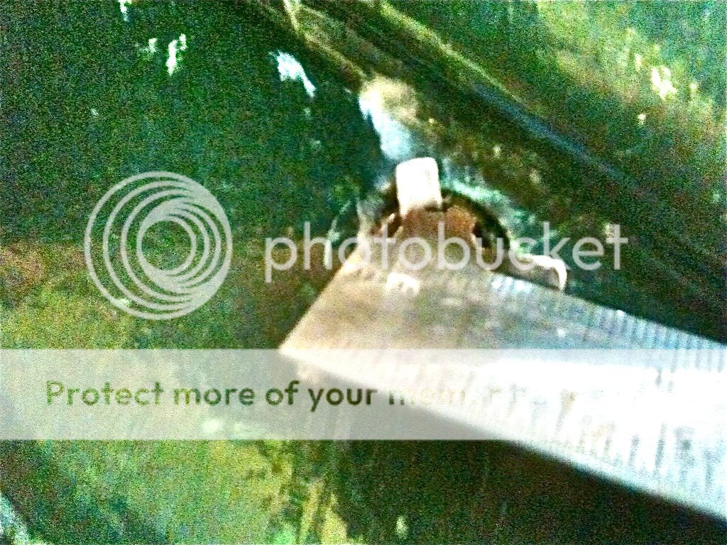

    I would like the drill size for the two holes in the decklid for the hardtop mounting . please make the measurement with the bezel removed TY

      sorry for poor photo, but the diameter measurement I get on my 65, without removing the bezel is 15/32".

        Well, the AIM calls for 1/2", so with a little paint build-up - 15/32" is right in there. Side holes are 29/64" FWIW.
