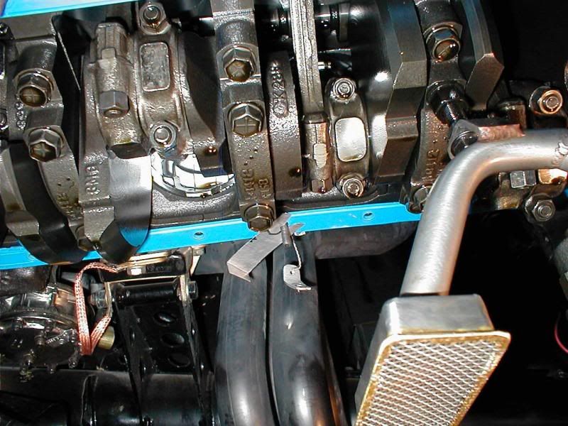

              1. If you are installing this with the engine in the car, make some clips (about 6) to support the gasket while you bring the oil pan up to the block. I used six strips of thin, aluminum flashing and made "U" shaped openings at one end so they could be removed once the pan bolts were started.

                Re: 56 oil pan gasket info needed
                Jim -
                The Fel-Pro one-piece pan gaskets I've used came with threaded plastic "hold-ups" that did the same thing - saved making them.
                        Jim -
                        [ATTACH=CONFIG]48316[/ATTACH]
                        Looks like that's a different part number, John. For certain the 1885 (which I bought about 5 weeks ago) didn't come with the "hold-ups". It wasn't a big deal to me since I made those clips 13 years ago when I was building my Grand Sport. I just hung on to them and they come in handy from time to time.
