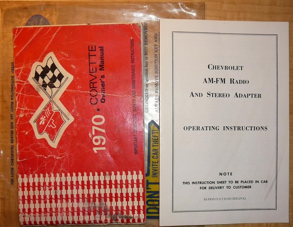

    Which radio instructions sheet is correct for a 1970 AM-FM Radio Stereo equipped car? Does anyone specialize in originals? If it's the latter, where can I get one?
    This is what I currently have(believe it's a repro).

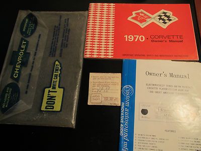

    This is what I found on another website, a different style book/Owners Manual with "custom autosound" listed on the blue stripe.

    The one in the top photo is the correct style, and yes, it is a repro. Bottom of the page says Reprinted from original. It is rare that we find an original in judging. I have never seen the style in the lower picture in a Corvette. Perhaps Dave can respond as he is very knowledgeable about paperwork.

      For your 1970 you need a radio sheet with part #7306110. That sheet was used from late 1967 through the 1970 model year and possibly into 1971. 1967 thru 1968 also used #968 and #199 radio sheets. There are obvious reproductions like yours and others that are not as obvious. A real #110 sheet will easily get $250 or more on the retail market.
