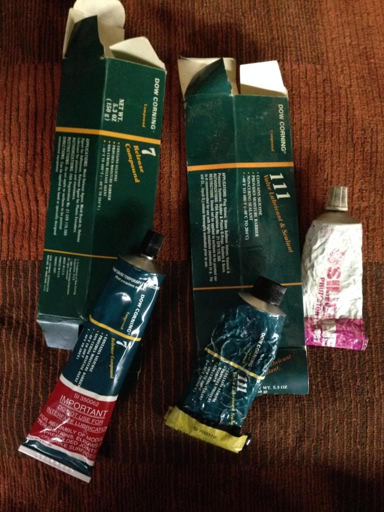

            Here are just three that I was able to grab quickly from my stock. The mold release is the Dow 111 in the middle. The number 7 (left) is an insulating grease. It is slippery and will work fine for the radiator hose application we have been talking about. One must be careful with it around electrical connections, however.
