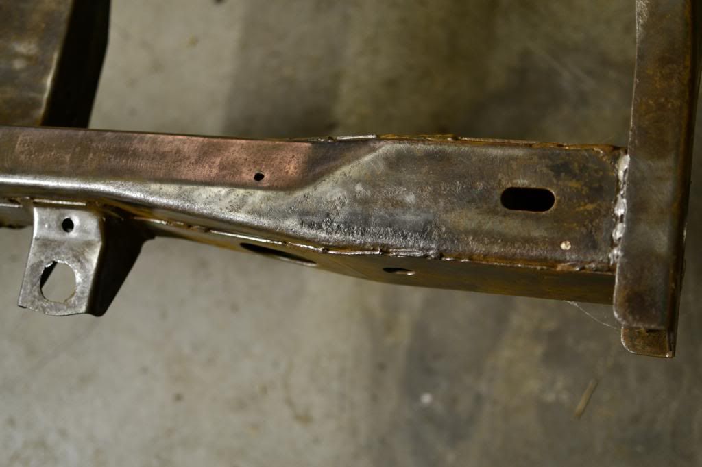

                  the photo of the vin on the frame shows its position well behind the #4 mount? I guess I've been looking in front of that. And what would the part number for a 75 automatic convertible with a trim tag build date J08 frame be? I have scraps and remnants of my tank sticker. Would anything on it help?

                      I've also have been looking in front of that. Unfortunately, that location on my frame is in the worst condition. Remnants of the VIN can be made out.

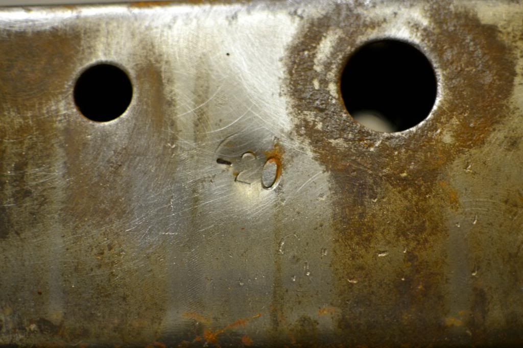

                      I also have this "-20" stamp in the middle of the rear cross member.

                        Wow, I haven't even begun to excavate that far back on the rail. So funny how a "unique" the assembly process was with these cars.
