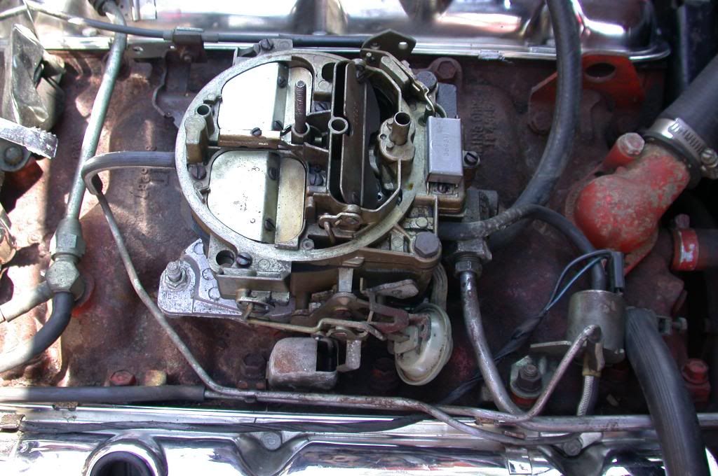

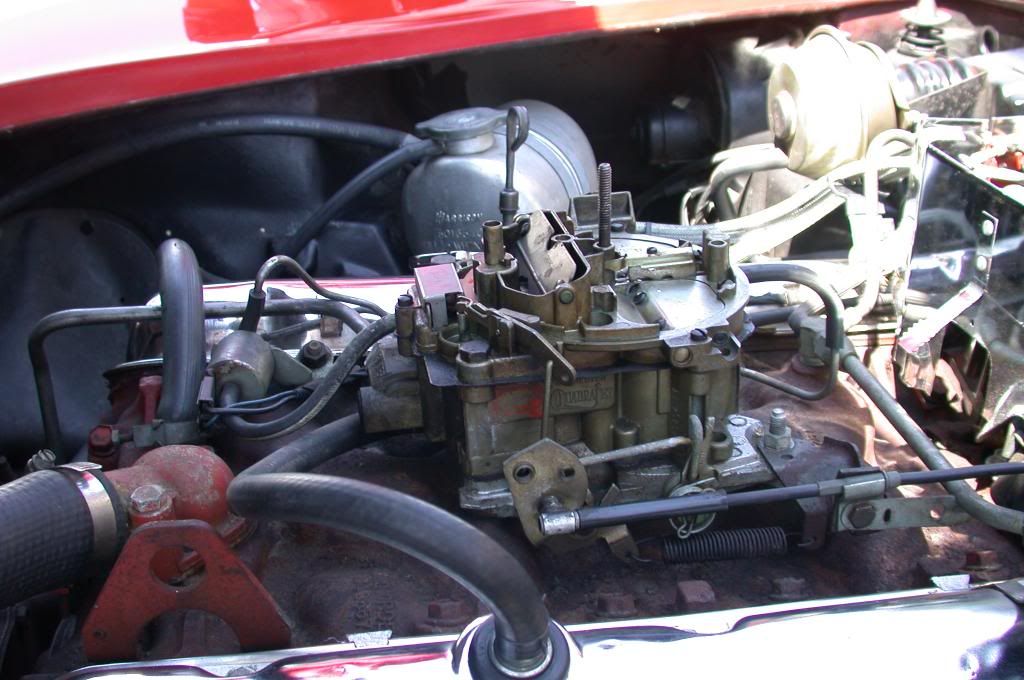

I am working with a restorer on a '70 bb coupe and our goal is to have a finished product that looks and operates as original. We are in the process of putting the engine together and we are a bit stumped with the TCS system. Does anyone have a pic, or pics, they can post for me, of what an original TCS system looks like? We are having trouble reading the assembly manual as to what it is supposed to look like, and all we have now is a lot of bent tubing - it appears that some of the system was removed, and the rest disabled, sometime in the car's past. It's a '70 big block THM w/o A/C. Thank you! Randy C.

Here you go:I am working with a restorer on a '70 bb coupe and our goal is to have a finished product that looks and operates as original. We are in the process of putting the engine together and we are a bit stumped with the TCS system. Does anyone have a pic, or pics, they can post for me, of what an original TCS system looks like? We are having trouble reading the assembly manual as to what it is supposed to look like, and all we have now is a lot of bent tubing - it appears that some of the system was removed, and the rest disabled, sometime in the car's past. It's a '70 big block THM w/o A/C. Thank you! Randy C.
Terry- Top
Re: 1970 bb coupe engine restoration
Even though I know it is not your thing - I confess. I had malice a fore thought in adding that picture as it barely filled Randy's request.
I am pleased you caught it so soon Mike. We have to get together once the Spring thaw comes.Terry- Top
