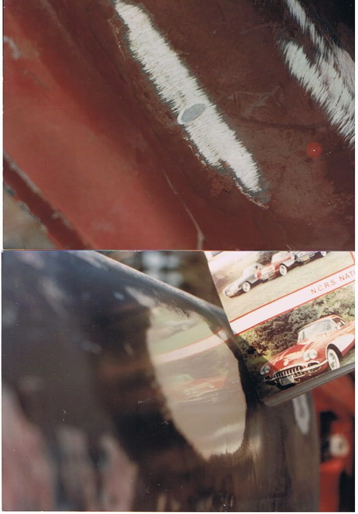

          The primer I see on 54s is more dark gray than brown. Almost all of the 50s cars up to early 63 used the dark gray.
          Here is a picture of a 54. It happens to be one of the odd white gel-coated bodies.

            Re: 1954 Factory Primer Color?
            54 vin 2184, 57 1093 ,57 4450 and several other c-1s's i'
            ve stripped had dark gray primer as wayne shows. mike
