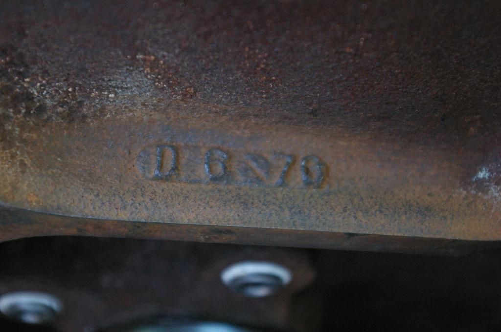

        Tom thank you so much for coming forward and presenting your block and associated stamp pad which is clearly correct.

          Tom would it be possible if you could provide a picture of the drivers side of your block where I could take a look at the 2 cap plugs indicating the
          4 bolt main block? Thanks and best regards.

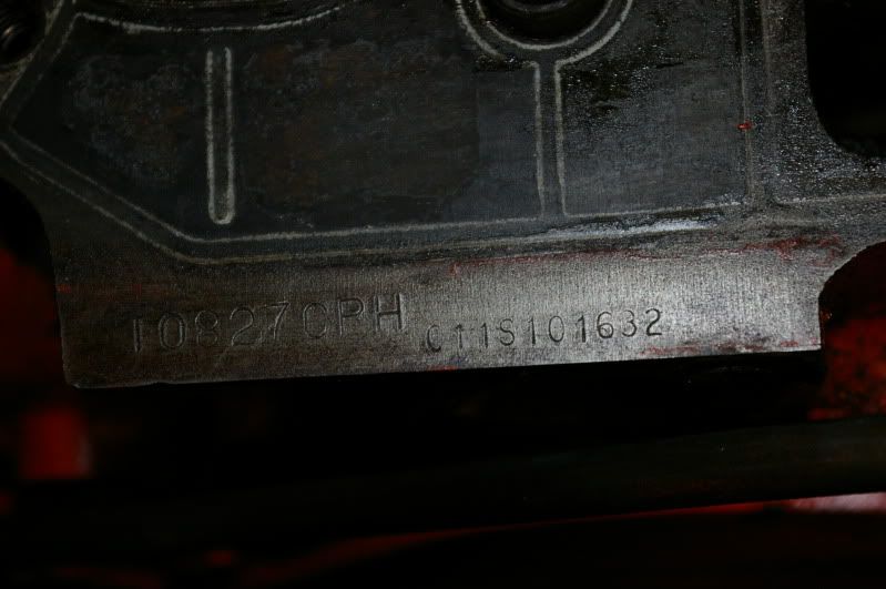

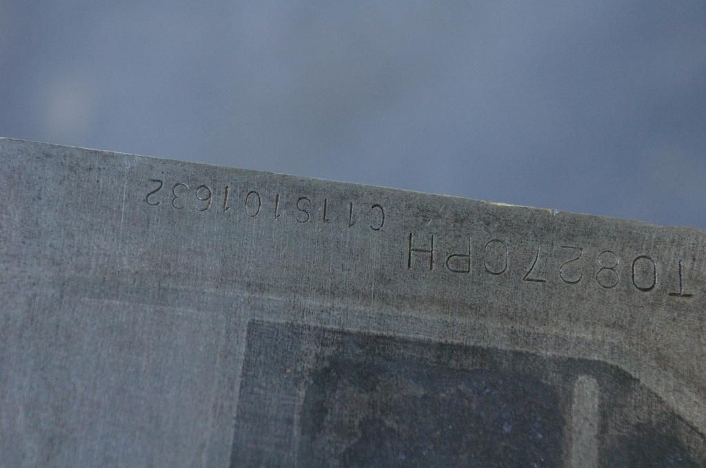

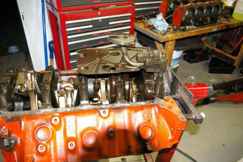

                      Here are some more pics of my block
                      Tom
                      2007 Z06, Lemans Blue

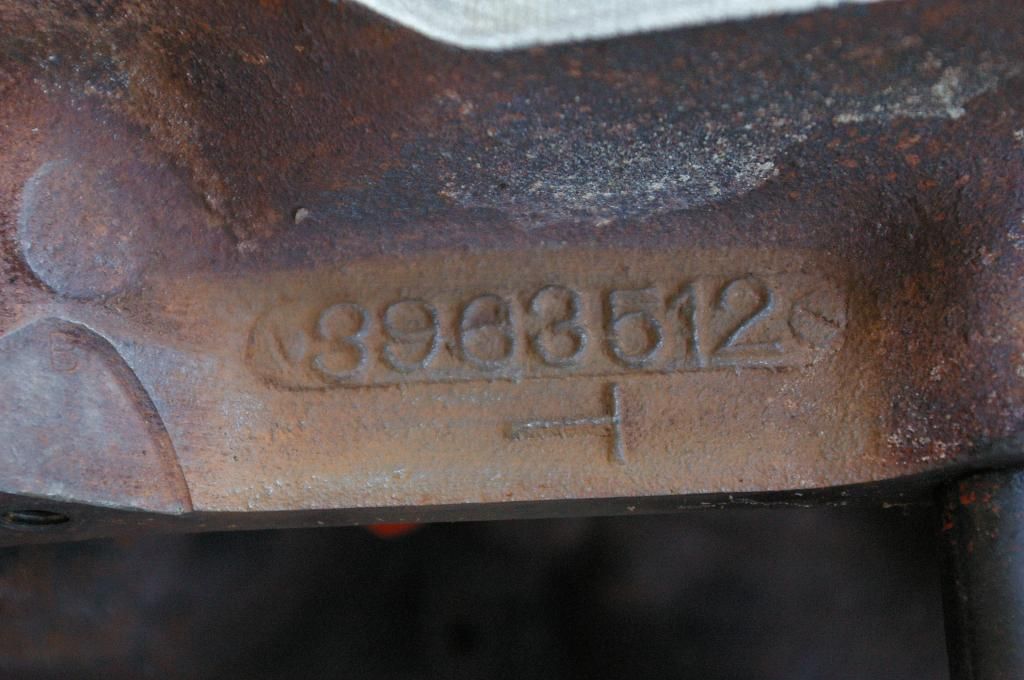

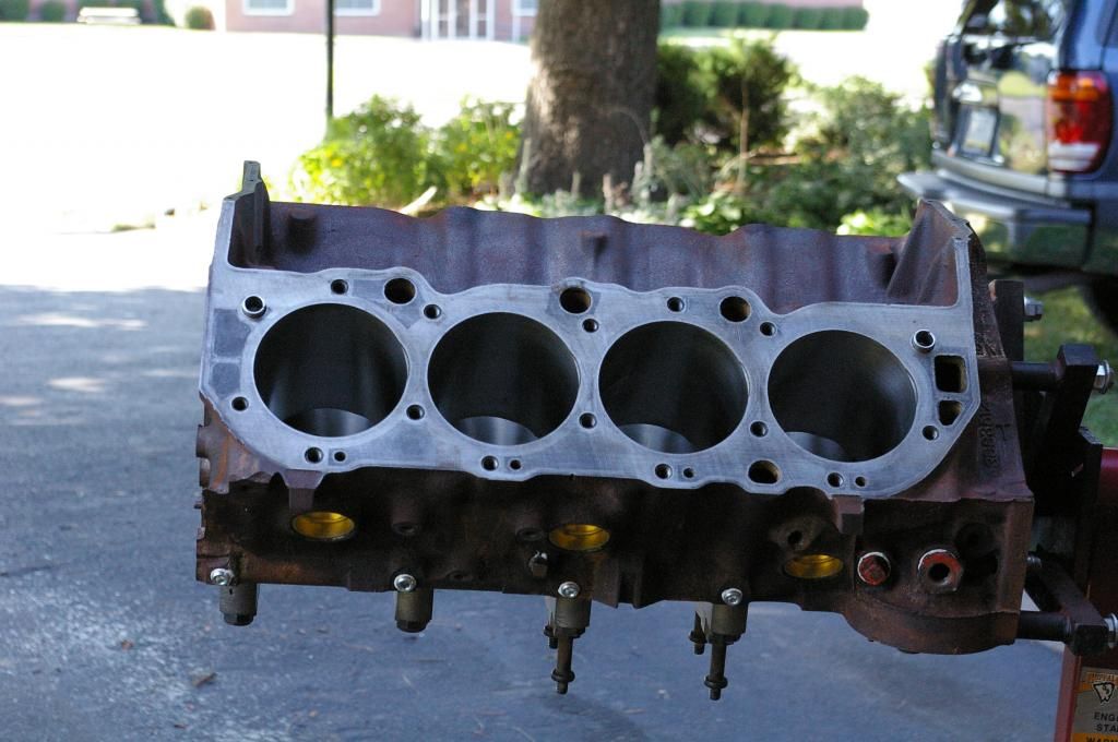

                      • Thomas H.
                        • August 31, 2005
                        • 1053
                        Re: LS5 454 two or four bolt main? or BOTH
                        Tom
