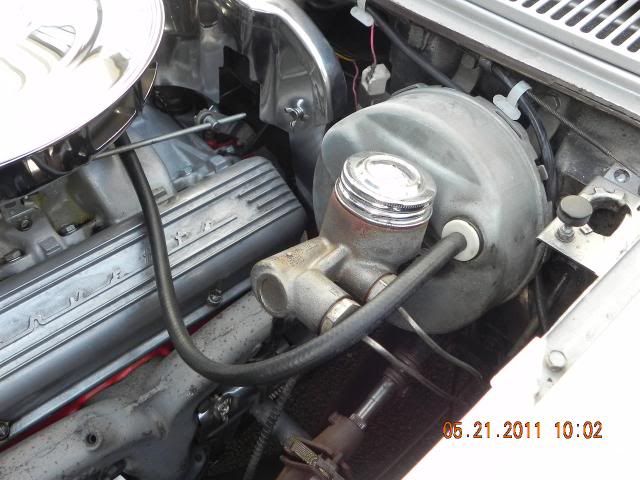

The Z-06 Special Performance Equipment Package for 1963 had two iterations. The first, only available on Coupes was really only available to select customers who were experienced Corvette racers. It included the following equipment:
360 HP FI engine
Four-speed manual transmission
Positraction axle (choice of six ratios)
HD suspension (550 front, 305 rear lb/in spring rates, 15/16" front anti-roll bar, special shocks and rear lower shock mounts)
HD drum brakes (large dia. finned drums, metallic linings, vented backing plates, dual-circuit m/c w/ vacuum booster)

I was the one that told the owner it was a Z06, he didn't know what one was. The original brake drums and linings had been removed because of complaints by the original owner by the dealership with supporting GM paperwork documentation. The backing plates with all the original block off plates were still intact. The car is factory black with a factory tan interior with the leather seat option, a stunning combination. The wheels as you can see are the pin drive Halibrands. The body on this car before the fire was unbelievably straight. The owner got the car running and drove it around his yard prior to the sale. This will be a fantastic car when its restoration is completed.- Top
