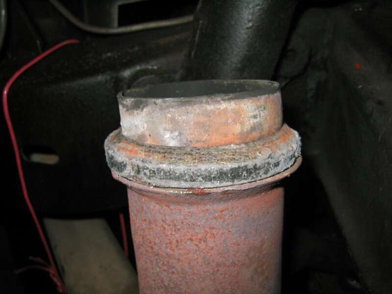

                    • Brian Monticello
                      Re: What is an "exhaust donut sleeve" used for?
                      A picture for the words:
