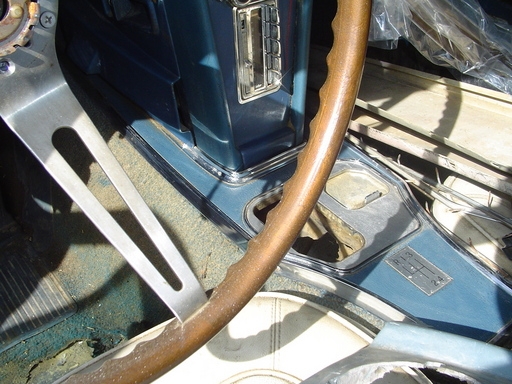

                Joe,
                It doesn't make sense to me either! I can tell though, My wide-ratio is correctly numbered and dated. Also, I pulled everything apart myself and got that 'this has never been touched before' feeling. I'm positive I was the first to loosen the two large 'M' bolts that hold this bracket up to the tranny. Here's a shot of my 4-speed center console, original to the car, and I was also the first to unbolt this. It still has the original carpets with the part #'s glued to the bottoms. Anomaly?
                Justin #41362
