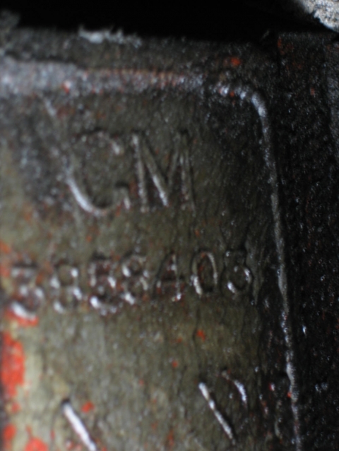

        Joe,
        Bell housing is a 3858403. The starter images to follow.
        Jim

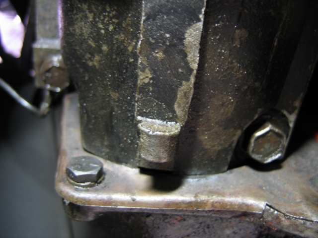

          Re: Engine identification
          Joe, The starter does in fact have the long and short bolts. What do you make of it?
          Jim

            Jim------
            The 3858403 bellhousing is the one I would expect for the 1965 L-78 application. The starter configuration is what I would expect. In your most recent photo the exposed metal areas of the nose look like they could be aluminum, as I would expect.
