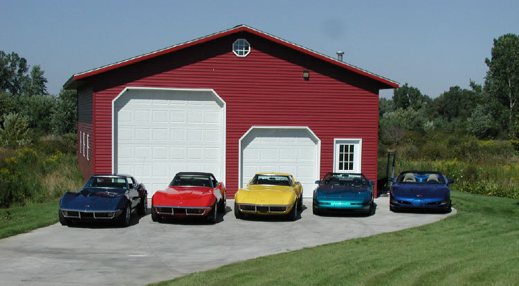

                  • Don 42616
                    Re: C2 - garage storage - 4 post lift
                    Pat, What a beatiful garage & colection. Is the Blue vette a C6 or C7? Don

                          • 11608
                          Left to right:
                          1971 Bridgehampton Blue coupe
                          1972 Mille Miglia red convertible
                          1972 Sunflower Yellow coupe (TF and Bowtie winner)
                          1992 Bright Aqua Metallic conv 6 speed
                          2002 Electron Blue conv with 1995 miles (at present)
                          Patrick
