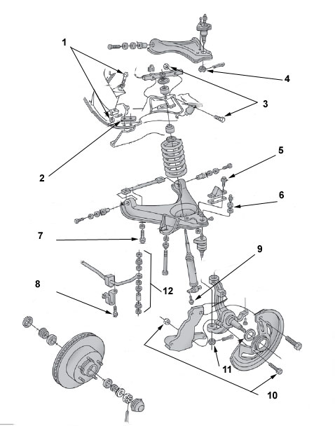

    Travis-----
    1= zinc plated
    2= plain
    3= bolt= black phosphate; nut= zinc plated
    4= plain
    5= zinc or black phosphate
    6= nut=plain
    7= black phosphate
    8= zinc or black phosphate
    9= zinc or black phosphate
    10= bolt= black oxide; nut= zinc plated
    11= plain
    12= all metal parts zinc plated

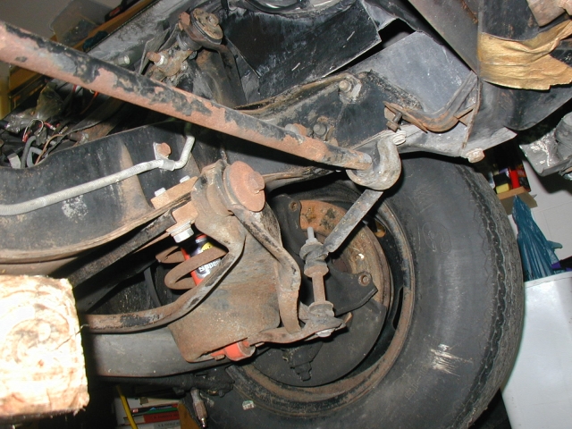

          • Travis Williamson
            Re: 70 C3 suspension fastener finsihes
            Joe
            Here is a good example why I needed help. Thanks again!
            Travis

                Travis------
                The brake line clip bolts, not part of your previously posted diagram, were originally black oxide finished.
                A tip: when examining fastners which are thought to be original but with deteriorated finish, if the fastners are seriously rusty, they were very like originally black phosphate or black oxide finished. These finishes deteriorate rapidly in a chassis environment. Zinc or cadmium plated fastners hold up MUCH better. Usually, even if they are rusty, there will be some evidence of the original zinc or cadmium finish remaining. In fact, this photo illustrates that perfectly. I meant to mention that in my previous response but forgot. Your photo reminded me.
                  • 43193
                  Travis------

                    Wow...What a workout! Travis, I hope you know that this kind of information is priceless; better buy Joe a dinner when you meet him next. Huh?...No questions on the bushing retainer bolts and washers, or that big honking 9/16" bolt through the backing plate?
                    For the most part, the recorded finishes on my late 70 (G30) agree with Joe's info except for a few items. My records show a question mark (?) after some of these finishes where we disagree. That may mean that I couldn't decide if a finish was black oxide (BLO) or black phosphate (BLP)...Or, in the worst case, it may mean that I had already bead-blasted the fasteners before I got organized, and was just GUESSING at the appropriate finish. DOHP! (Well, I'm not sayin'...;I'm just sayin'...) So, this may be an education for me as well.
                    In cases where Joe gives two choices, I'll tell you what mine had. For reference, Joe's finishes are in parenthesis; any numbers not shown means we agree perfectly.
                    1. BLO? (Zinc)
                    2. BLO? (Natural)
                    5. BLP (Zinc or BLP)
                    8. BLP (Zinc or BLP)
                    9. BLP (Zinc or BLP)
                    10. Zinc/zinc (BLO/Zinc)

                      • Travis Williamson
                        Hi Chuck,
                        Thanks for the fastener info. Youre right, it is some valuable information and Im very grateful for the info you hand Joe have given me as well as others.
                        What did you do to get back the correct finishes? Did you refinish them or did you just by new ones?
                        Since I am trying to keep as much original stuff as possible I was thinking about ordering the black oxide kit from eastwood.
                        As for the zinc the plated items I may just have to leave them alone or just buy new if possible.... The tin-zinc plating kit eastwood offers is kind of expensive and I dont even know if its the right finish.
                        Any ideas?
