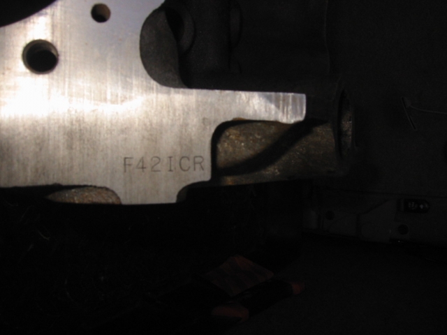

    I just had my block restamped. I'm concerned that the numbers might be offset too far to the right and possibly the spacing between the numbers/letters is too wide. I'm trying to decide if I need to have the area built back up with metal deposition and then have it restamped.
    Any comments?
    Dave

    What is your date supposed to be?
    I think you have a "0" missing if you mean April. F042ICR for apr 21st.

        No leading "0" until mid January '60.

          Thanks. I should have mentioned that the block is dated April 18, 1959 and that the build date is April 21st 1959.

            I assume it was not F04... before the re-stamp?

                yes. The original stamp was F428xx I cannot remember the specific engine code (i.e. last 2 letters).

                  This is good, restamp and have NCRS review? *NM*

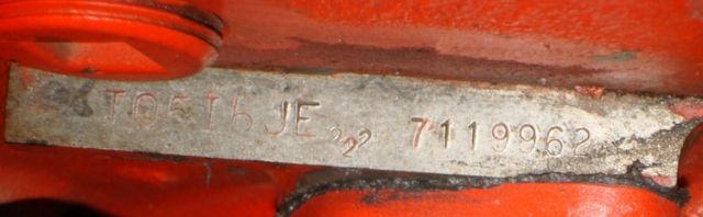

                              And, is this a restamp or original?
