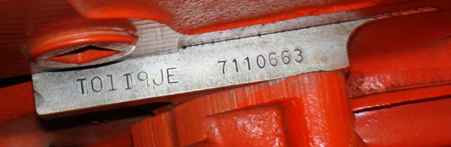

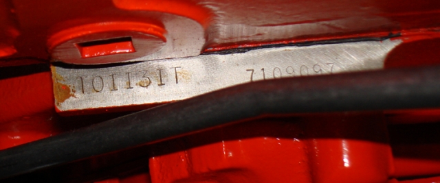

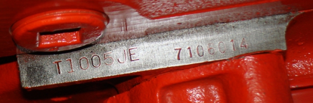

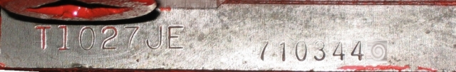

                      So which are Restamp or Original?
                      So which are restamps?
                      1
                      2
                      3
                      re 3
                      5
                      6
                      7
                      first re 7
                      second re 7
                      9
                      They aren't as easy as this one.

                            So they're all re-stamps Chris? *NM*
                            • Chris Patrick
                              #29
                              Almost 250 views and no comments on the stamps?
                              No, only a few are restamps that I know of. There are several that are real.
                              Makes it hard, eh?
                              Now try that with the uneducated public and see why so many restamped engines get passed off as real and the dollars go out of sight.
                              • Mark #28455
                                #30
                                I pick #3
                                Since only about 3 of the original 20 L88's still have the original block and it appears this one has circular broach marks, I vote for it.
                                Mark
