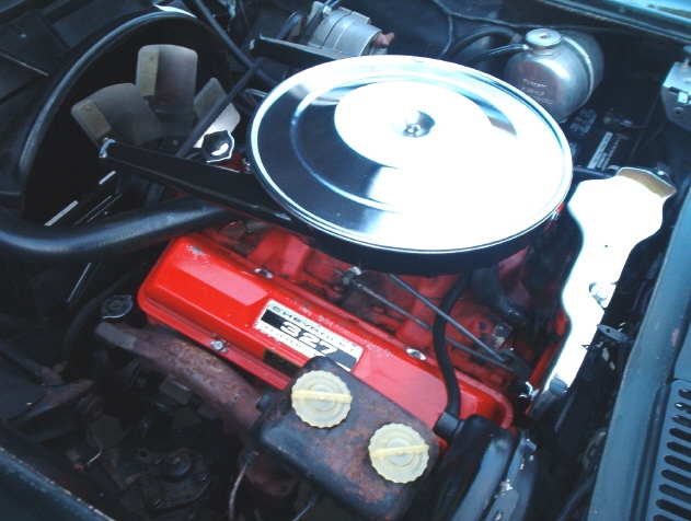

      Why not just post some pictures here for everyone to see?
      It is easy. You can post one picture at a time. You need a web host, but those are easy and you may already have one with your email service. If not, go to tinypic.com and upload the pictures from your computer. It is free.
      In the picture I posted below, I found IM001587.JPG on my computer using the Browse button.
      Click Upload Image button.
      Then copy the URL Link: for email and instant messenger
      Paste that in the Optional Image URL: box under the message bost you use to respond to this note.
      Click Preview Message to see if it works right before posting. Be sure you do not have at the beginning of any URL.
