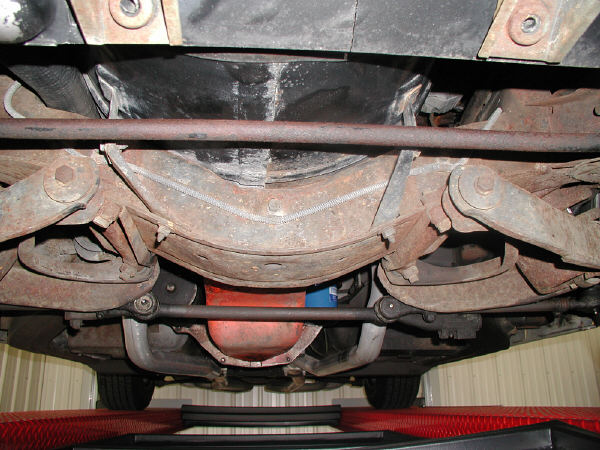

                    Take a look at my car frame below. I really thought about trying Ridrust until my experience with smaller parts made me rethink that idea. 3 Top Flights and a Bowtie Award later, I'm not too worried about it any more.
                    Patrick
