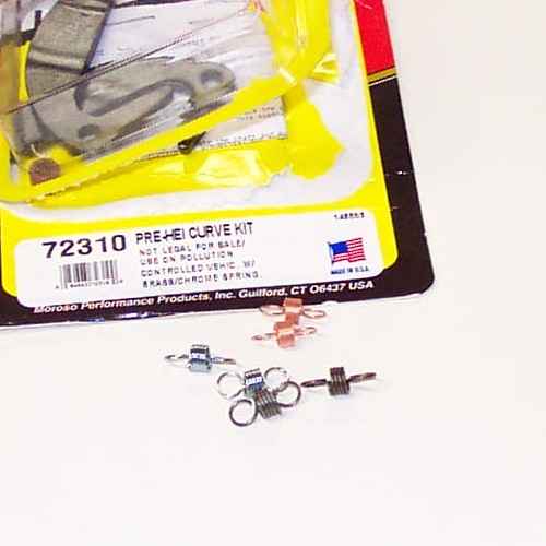

    Just got the Mr.Gasket 928G advance springs....As you can see the ends are off-center whereas the OE ends are on the center line axis of the spring.....problem?
    Also, it appears the sequence in order of strength is black, silver, gold. Is that correct

    Re: Aftermarket Advance Spring kits....MrGasket
    From visual inspection, the black set is likely the heaviest since it has the fewest number of coils. I can't tell visually on the other two sets, but you can probably discern a difference in force by stretching them manually.

    Orientation shouldn't be a problem as long as the body of the spring doesn't interfere with anything, but there might be a "preferred" orientation with the end loop either on the bottom or top. Check them both ways.

                • Pat #25912
                  Jim, here is a pic of the Moroso kit. Spring loops are centered, not offset like the MR Gasket.

                      • Randy S.
                        • January 1, 2003
                        • 586
                        Jim,
                        The LIC spring kit(part #48-05) has weights, bushing and 2 spring sets. The loops on the springs are centered on the spring axis like the Moroso kit pictured. The instuctions say to install the light springs on 250 300 350 390 hydraulic lifter eng. The heavy springs on solid lifter engines.
                        My car is a 66 300HP and I have a 1111153 correct distributor. The shop manual says 26* @ 4100 advance. I am getting about 24 IIRC. Others have advised this spec is incorrect and AMA specs say 30* @ 5100 so I will try to get there.
