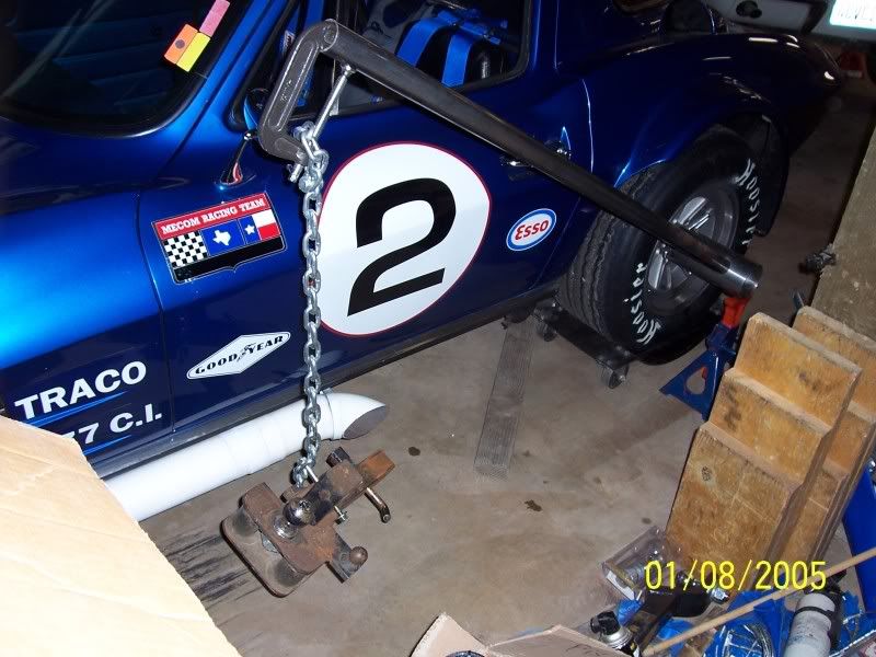

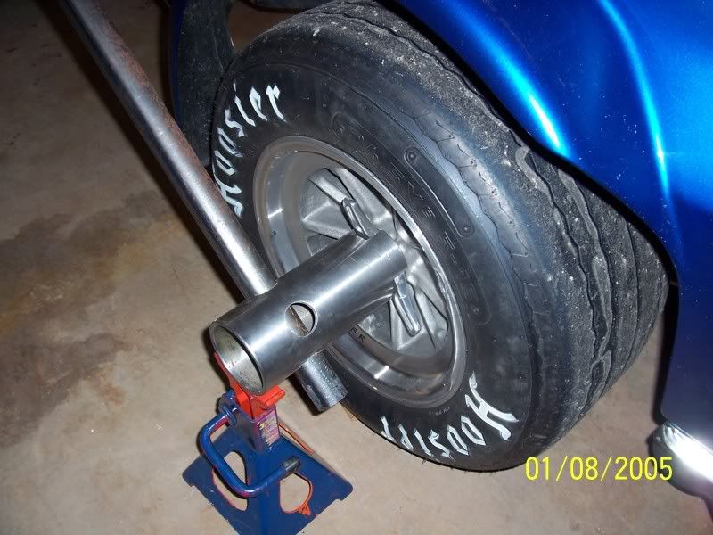

I once had one of the spinners on my bride's Grand Sport track car seize up. Broke one ear off pounding on the dang thing.
What eventually worked was the use of a tool I had fabricated to preload the spinner with just over 1000 ft-lbs of loosening torque and simultaneously pounding the bejesus out of the remaining two spinner ears. The attached pictures may give you an idea you can use to get your spinner off.
If you do something similar, you'll want a helper in the car STANDING on the brake pedal. 1000 ft-lbs is more than enough torque to overcome whatever friction the tire has against the pavement.
Jim- Top
