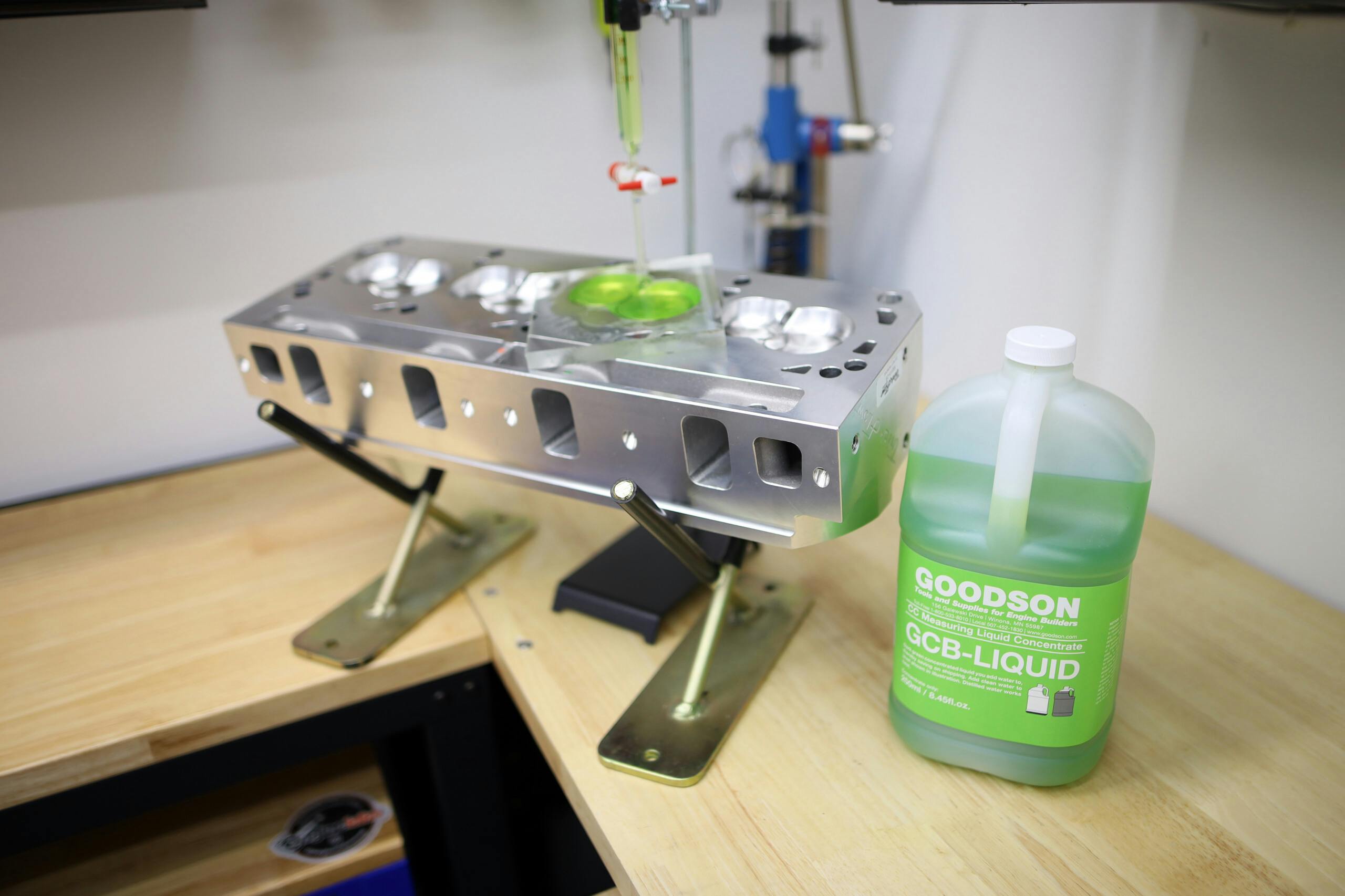

    Google is your friend. Example hit below.
    Dave
    Measuring your cylinder head's combustion chamber volume is a critical step to ensure that you have your desired compression ratio.
