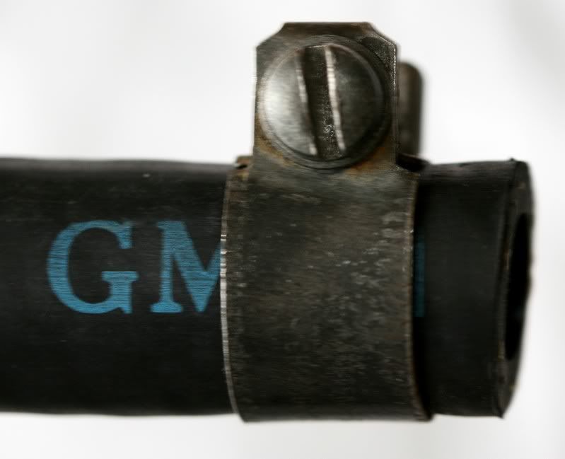

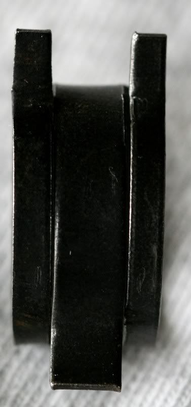

      The JG calls for tower clamps on the hose in between the rediator and the overflow tank.
      A few shots of a #2 size clamp:

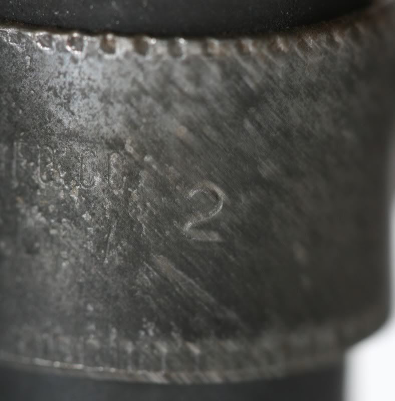

        Re: 69 Hose Configuration
        Originally posted by Jeff Groover (46451)

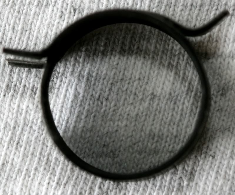

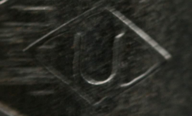

        Last question, was there always a tower clamp on the PCV hose? I saw a car recently with a spring type clamp there (like the kind used on the brake booster hose).
        A few shots of the spring clamp used on the PCV hose as well as the power brake booster hose. My apologies as the last one, showing the manufacturers stamp, is a little blurry.

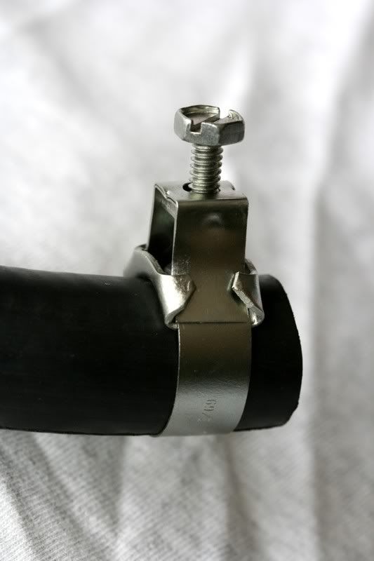

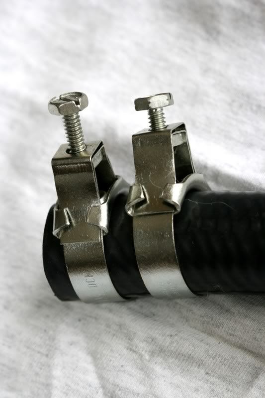

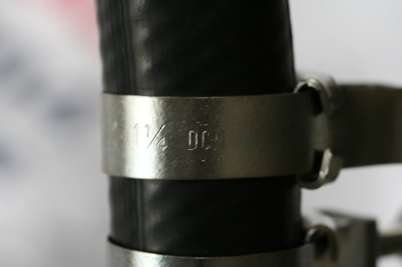

          If anybody is interested, here are a few PICS of the 1 1/16 and 1 1/4 heater hose clamps. These are original, but, have been replated. As those of you intimately familiar with restoration will quickly notice, these have not been installed on the car, yet.
            Mark, Thanks for the pics. It appears that the JG imight be incorrect in 2 areas regarding the clamps. Terry I can't seem to find that illustrtion you mentioned. My JG does not have it either.

                  Now if I can remember to take the picture, I have some unused DCM tower clamps (none for sale, to use a popular expression around here) I'll post for Mark.
