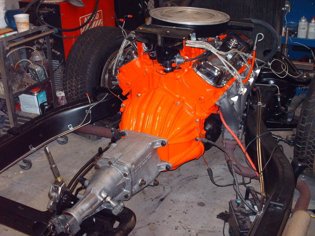

      I just had it sandblasted and brushed on POR15 chassis black. I wasn't going for the judging thing, just wanted it looking good.
          I like that exhaust exiting behind the front tires.
