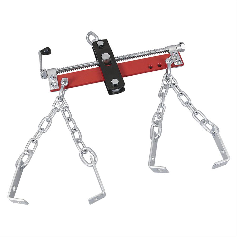

                  Re: Pulling the motor
                  Originally posted by Dennis Stubee (41797)
                  Oh, and use a good engine leveler...makes all the difference in the world.
                  Dennis,
                  Hopefully not hijacking the thread too badly, where is a good place to get an engine leveler? Any particular specs to keep in mind when shopping?
                  Joe
                    Originally posted by Joe Raine (45823)
                    Dennis,
                    Joe
                    The cheap ones work as good as the expensive ones. Mine came from Harbour Freight. I've used it many times with no problems.
                    Paul

                      I borrowed an engine leveler. Someone on the CF bought one similar and posted the following link. The L-shaped tabs may have to be modified for the attachments at the rear of the block...so as not to interfere with the firewall. I would remove the distributor and carburetor first. When reinstalling, leave out the exhaust manifold studs...they can only interfere or scratch something...the BB is a tight fit. If you place the rear wheels on ramps or raise the rear of the car higher with jack stands, the added angle really helps when installing the engine and tranny as a unit. Three sets of hands is great, four is even better.
                      http://www.amazon.com/OTC-4305-1500-...0226964&sr=8-1
                        Paul & Dennis,
                        Thanks for the good information! I couldn't find an engine load leveler on Harbor Freight's web site, but I did find this one for what seems to me like a pretty good price on Summit Racing's web site.
                        Free Shipping - Summit Racing™ Engine Load Levelers with qualifying orders of $109. Shop Engine Tilters at Summit Racing.
                        Joe
                          Paul & Dennis,
                          Joe
                          That'l work. Mine is Item # 5402, and it appears from the web site that it is discontinued (although I recall seeing them in the store not too long ago). Northern Tool has one (in the link below) but the one you've found is the same design and a much better deal. I also checked Grainger and they're even more expensive.
                          http://www.northerntool.com/shop/too...atchallpartial
