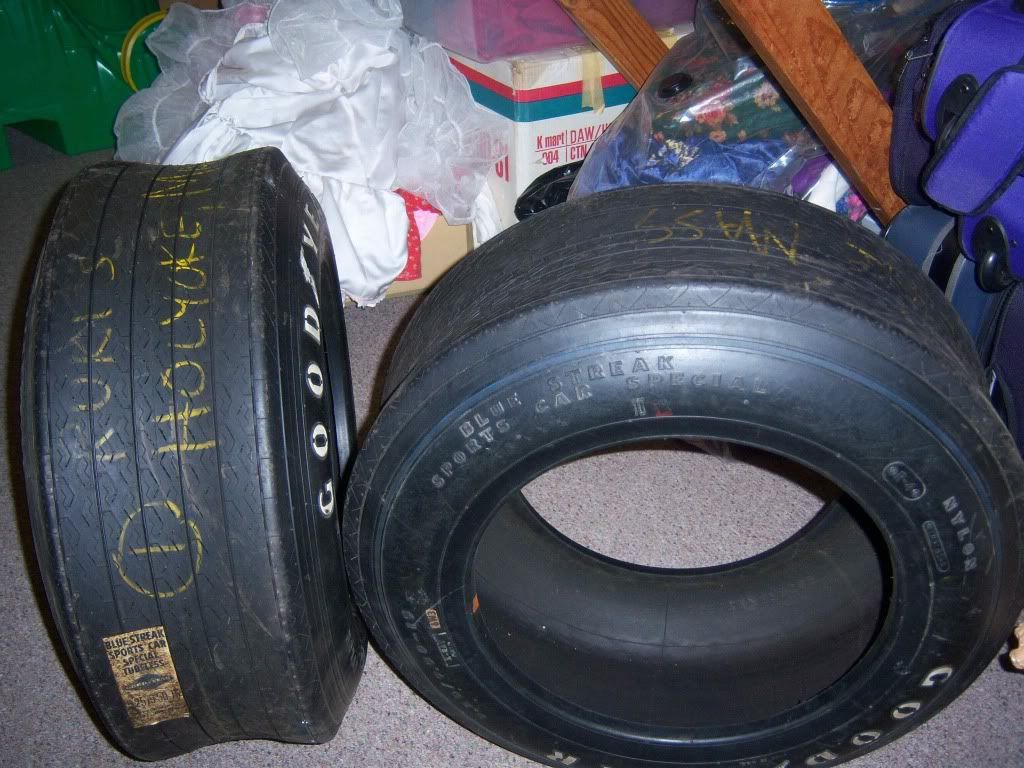

                      • Jon M.
                        • February 2, 2010
                        • 13
                        #56
                        Re: Goodyear Bluestreaks
                        Thanks, Rex. I appreciate the link. They look like the G12 tread pattern but it looks like the lettering on the side is larger. Would you please post a picture of the tread pattern on your original 7.00 x 15s when time allows?

                          • Duke W.
                            • January 1, 1993
                            • 15610
                            #58
                            Rex - do your tires have an "R-number" molded into the sidewall, like R4?
                            These tires are 1963-64 vintage. I almost bought a set in 1964 to replace the OE General Jetaires that I chunked hot lapping my SWC at Kent, but I went with Michelin X radials instead. Given that I lived in Seattle at the time, I figured the excellent wet grip and durability of the Michelins would be better for my driving conditions and undergraduate engineering student budget.
                            I believe the R4 version is a fairly hard compound and were considered dry/intermediate. I think there was also a full wet version. I don't remember the R-number, but the tread had siping, which are small slits in additional to the grooves and a softer compound.
                            These tires became obsolete very quickly as racing tires got wider and lower with softer compounds. The cord angle (measured from the circumferential centerline) is about 25 degrees versus about 35 degrees for road tires. As a result, the sidewalls are very stiff. The cord is nylon and I think four plys.
                            The basic construction was more akin to contemporaneous truck tires than pass. car tires.
                            No doubt a set of these tires on KOs or Torq-Thrusts is very period cool!

                            • Jon M.
                              • February 2, 2010
                              • 13
                              #59
                              Thanks for posting the tread pattern, Rex. I'm not sure I've seen that style of tread before. My NOS Bluestreaks below are the R-4 tread pattern for '67.
                              • Duke W.
                                • January 1, 1993
                                • 15610
                                #60
                                I can't make out the size from the photos. What size are they?
                                Vintage is probably late sixties - very different than early sixties.
