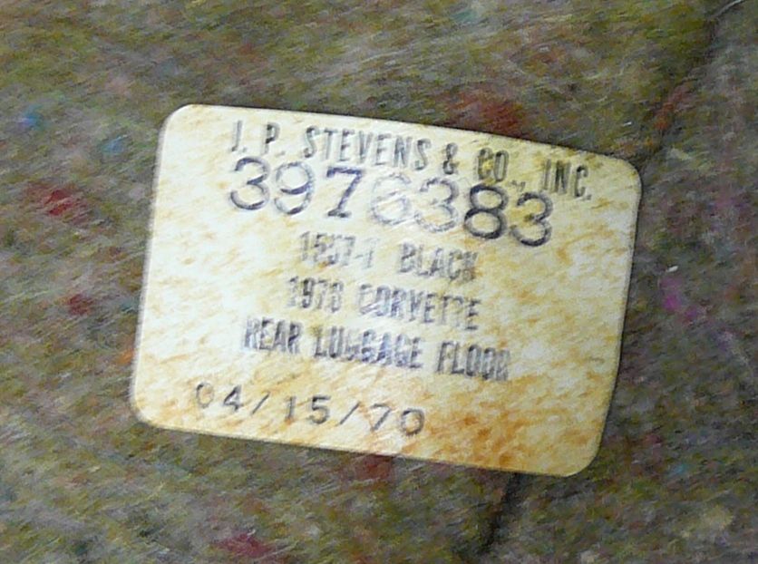

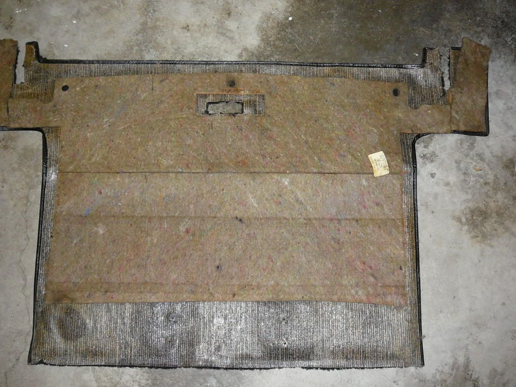

          Re: 1968 carpet question - rear of coupe
          This is what my 70 coupe looks like.
                  When I removed my carpet in the 68, The backing material remained on the wheel wells in the area highlighted by the arrows- is this what you are looking for?
