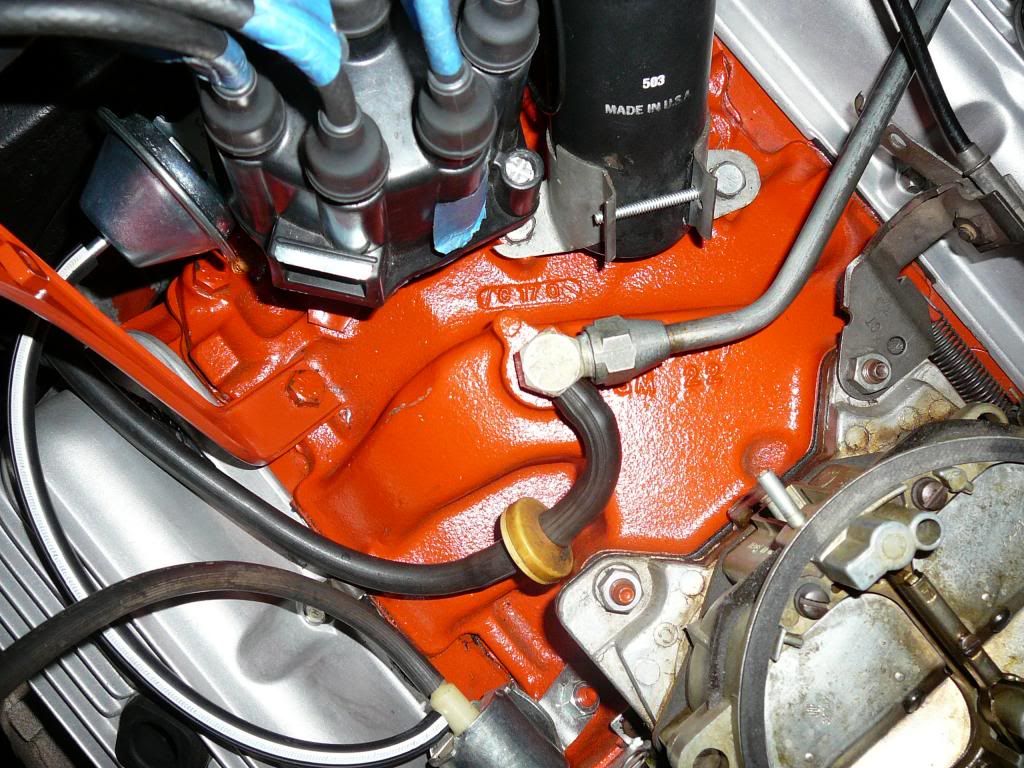

    Guys, attached is a picture of what I'm referring to.
    The number one spark plug wire on my L36 is located one terminal over from where the manual says it should be. This is causing the vacuum advance can to hit the ignition shielding. The Service manual shows the number one "should" be above the points adjusting window, but I've also seen a lot of L36's (and other big blocks) with the number one just to the (in my picture) left of that. So which is correct and where is YOUR number one spark plug wire located?
    Thanks
    Ed

    You could have installed the distributor "one tooth off", or possible the distributor gear is not properly indexed to the rotor. The "bump" on the gear should align with the tip of the rotor. Could be a combination of both.

      I suspect Bubba has been working on your distributor. I'll assume your manual is correct regarding wire indexing, but if so, it's different than small blocks, which has number one on the terminal that's closest to the right side of the window opening.
      I suspect the distributor gear may be installed 180 degrees from the proper indexing. On small blocks the dimple in the gear must point the same direction as the rotor tip, and I assume this also applies to big blocks.
      Once you verify proper wire indexing for a big block, index the wires correctly, then set the crank balancer notch at the initial timing point BTDC #1 compression stroke. Remove the dist. and verify that the gear is properly indexed. IF not, knock the roll pin far enough out so the gear can rotate on the shaft and tap the roll pin back in. Then reinstall the distributor. You may have to tweak the oil pump drive to get the dist to fully seat, and when it does, the rotor should be pointing at the #1 wire terminal.
      Rotate the dist. housing until the points just begin to open. This is called "static timing" and should get the initial timing within a degree or two of where you set the balancer notch on the timing tab, so the engine will start right up. If you use an ohmmeter it should be within half a degee. Then use a timing light to verify/set the initial timilng with the engine running.

                The 1967 AIM shows for the L-36 (and other big blocks) the no. 1 position as the place Chuck identified as No. 1 and Edward labeled as where he had seen as No. 1 for other cars. I tried to set my L-71 distributor position today according to the AIM, but it is slightly off the index marks on the original manifold and distributor that I assume were marked by the factory. The mark on the distributor gears lines up with the rotor. However, since I have a Federal Mogul cam rather than a GM cam, it may be necessary to reverse the gear to line up the rotor on No. 1 at 8* advance while keeping the distributor housing lined up with the mark on the manifold.

                    Shouldn't the distributor vacuum canister be pointing towards the passenger side fender, on the aft side of the orange distributor shield bracket?

                      On a big block, a line drawn between the distributor cap hold down clamps would be perpendicular to the car's fore/aft axis with the vacuum advance pointing about 45* right of car axis. The number 1 spark tower is between the distributor cap window and the vacuum advance.
                        If the marks are only slightly off it's okay. Rotating the distributor gear 180 degrees will change the base clocking about 14 degrees at the same initial timing.
                        Also the initial L-71 timing specified in the AMA specs is five, not eight degrees. That may be why the stake marks don't align, not the camshaft. FM OE replacement camshafts are manufactured to the GM prints.
                        If it doesn't detonate at 8, leave it there. In fact, try 10.
